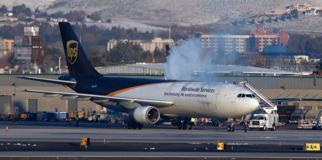

Had to reach way across from the east side perimeter to catch this morning shot of UPS's N161UP, an A306, getting a deicing bath prior to departing Reno.
The cargo birds are beginning to flock here. Yesterday morning, instead of our normal three or four aircraft on the cargo ramp, we had eight, including three heavies. Last year, on one of the evenings I was spotting during the December holiday shipping rush, we had thirteen on the ramp at the same time and five of those were MD and Airbus big birds. I'm hoping to get a 14-bird capture next month.

Sam, I've caught numerous clicks of paxbirds departing RNO with "green skin." That stuff costs $22. a GALLON?? Geesh! Could you think back on your experience to take a rough guess as to how many gallons would be needed to deice an A320 or a B737? I've watched (from a distance) the "Iceman" guys showering that green stuff on ... they must use a whole bunch of gallons of it. $22.00 a gallon! Does it spray out as a (sort of) "mist" or does it pour out as from a showerhead? In my pic here, it seems to be a "mist," but in my pic taken several years ago (at ORD at night) it was running down over the windows like it was raining out.
Being a mist it appears to be type 1..heated to 180 degrees F. It's a 55/45 mix of isopropelene glycol and water...it's pressurized like a firehose...the green type 4 is under less pressure and comes out like a sludge...
Steam means it's hot...so type 1 deice not type IV anti-ice
A 737 or a320 is all different depending on experience of the iceman and the total accumulation on the aircraft. Every airline different, some say just spray critical areas (wings tail nose) others say zero contamination on whole bird...average on a medium size jet would be 40-100 gallons
If it was watery it was deice...melts the contamination..think of it like a car wash...removes it...Antiice is like car wax..protects the aircraft from contamination buildup...depending on precip and temperature type 4 good for 2-20 minutes...
